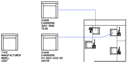

The following illustration shows a "chair" block with four attributes: type, manufacturer, model, and cost. Because the tags were set up as variables, specific information about each instance could be added for each inserted block reference.
Attribute information extracted from a drawing can be used in a spreadsheet or database to produce a parts list or a bill of materials. You can associate more than one attribute with a block, provided that each attribute has a different tag.
