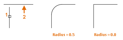

Set the Fillet Radius
The fillet radius determines the size of the arc created by the FILLET command, which connects two selected objects or the segments in a 2D polyline. Until you change it, the fillet radius applies to all subsequently created fillets.
Note: If the fillet radius is set to 0, the selected objects are trimmed or extended until they intersect; no arc is created. When the fillet radius is set to 0, you can remove the arc segment between two straight line segments or all arc segments from a 2D polyline.

Add A Fillet Between Two Objects or Line Segments of a 2D Polyline
  1. Click Home tab Modify panel Chamfer and Fillet drop-down menu Fillet. Find
  2. In the drawing area, select the first object or line segment that will define the points of tangency for the resulting arc.
  3. Select the second object or line segment.
