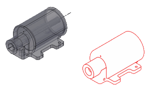

Creates a 2D representation of all 3D objects based on the current view.
Find
The Flatshot dialog box is displayed.
The edges of all 3D solids, surfaces, and meshes are projected line-of-sight onto a plane parallel to the viewing plane. The 2D representations of these edges are inserted as a block on the XY plane of the UCS. This block can be exploded for additional changes.
