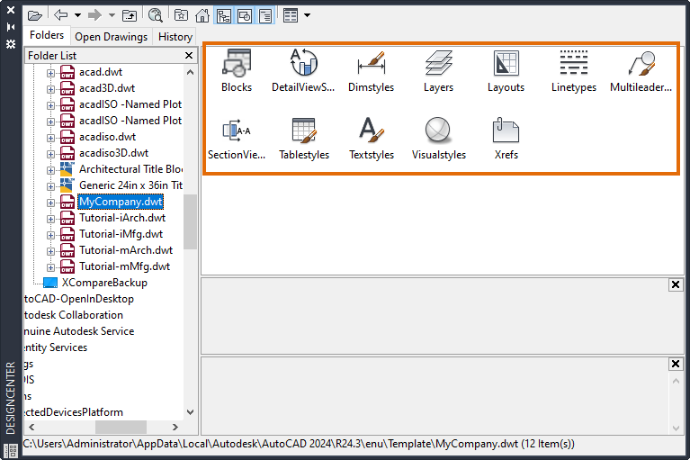

  1. Click View tab > Palettes panel > DesignCenter. Find
  2. On the DesignCenter toolbar, click Load.
  3. Navigate to the drawing, or drawing template, that contains the styles you want to import and click Open.
    The items available for import are shown in the upper right panel.

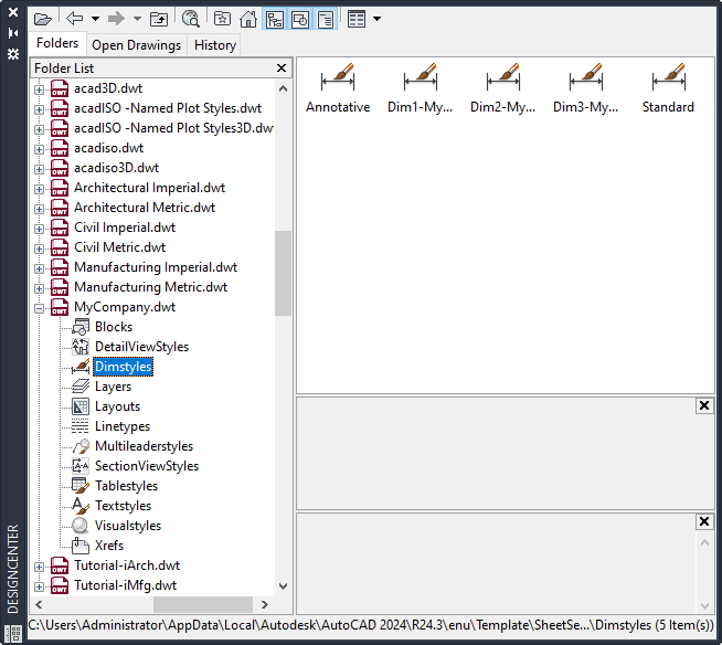

  4. Start with dimension styles by double-clicking Dimstyles in the upper right panel.
    The dimension styles defined in the drawing or template are shown.

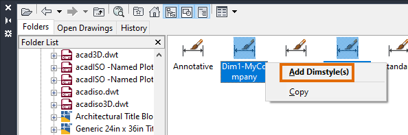

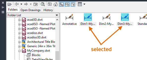

  5. Select the styles you want to import into the current drawing. Use the Ctrl or Shift key to select multiple styles.
  6. Right-click and click Add Dimstyle(s).
    The dimension styles are added to the current drawing.

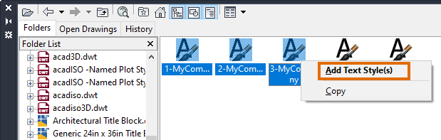

  8. Double-click Textstyles to view the text styles in the selected template.
  9. Select the styles for import, right-click, and click Add Text Style(s).

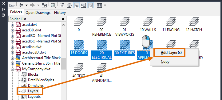

Note: You can also import layer definitions from DesignCenter.
