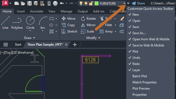

Add the Layer List Control to the Quick Access Toolbar
Looking for another way to quickly access simple layer controls? You may want to add the Layer List control to the Quick Access toolbar. This can be particularly useful if you like to close the ribbon as a way to maximize your screen real estate, but you still need to switch the active layer or turn layers on or off.
To add the Layer List control to the Quick Access toolbar, simply click the Customize drop-down on the Quick Access toolbar and select Layer.

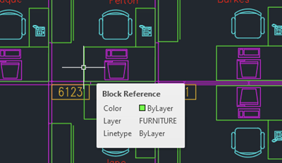

Suppose you want to make the FURNITURE layer current. Of course, you could simply open the layer list and scroll until you found the FURNITURE layer. But instead, let’s use Make Current to quickly change the current layer.
- Select an object in the drawing area that’s on the FURNITURE layer.
- Click
. Find
The FURNITURE layer is now the current layer.

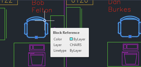

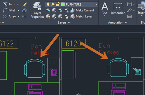

Use Change to Current Layer (LAYCUR command) to Quickly Change an Object From One Layer to Another
Just as the name indicates, Change to Current Layer (LAYCUR command) changes an object from one layer to another.
Suppose you wanted to change these chairs from the CHAIR layer to the FURNITURE layer using Change to Current Layer.
- Make the FURNITURE layer current.
- Select the chairs to place on the FURNITURE layer.
- Click
. Find
The chairs are now on the FURNITURE layer.

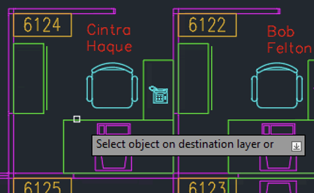

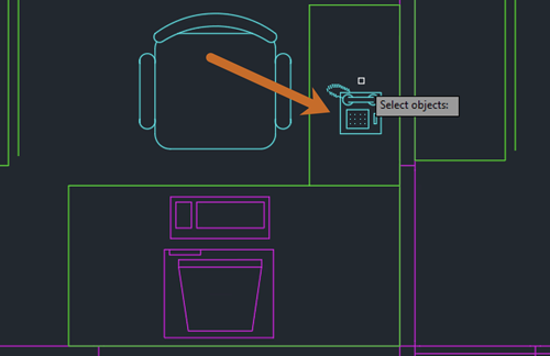

Use Match Layer (LAYMCH command) to Quickly Change an Object From One Layer to Another
Similar to Change to Current Layer, mentioned in the previous section, Match Layer (LAYMCH command) changes the layer of an object. Except with Match Layer, neither layer needs to be current.
Suppose you want to place the phones onto the CPU layer.
- Click
Find
- Select a phone, then press Enter. This is the object you want to change the layer of.
- Select a computer block to specify the destination layer. This is the layer you want to move the object to.
The phone is now on the CPU layer.

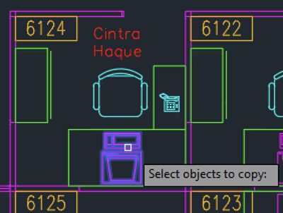

Quickly Copy Objects to a New Layer (COPYTOLAYER command)
With the previous two commands, we changed the properties of objects already in the drawing. But suppose you want to copy objects and place those objects on a different layer. This can be done with Copy Objects to a New Layer (COPYTOLAYER command).
This time let’s say you want to copy this computer onto the FURNITURE layer.
- Click
. Find
- Select a computer, then press Enter. This is the object you want to copy.
- Select one of the furniture objects on the destination layer.

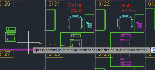

- Specify a base point (just like when using the COPY command).
- Specify a second point of displacement to place the object.

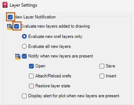

Receive Notifications of New Layers
You can have the program automatically notify you when any new layers are added to a drawing. New layers might be added when attaching external references or inserting blocks. Also, if you work with shared drawings, new layers might be added by other contributors.
When the Layer Notification feature is turned on, and a new layer is subsequently added, a balloon or dialog box message appears after specified operations that involve file operations, layer states, or plotting. The status bar also displays an icon that alerts you to new layers.
Let’s try setting up an automatic notification for new layers.

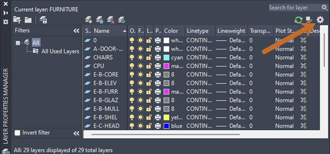

- Click
. Find
- On the Layer Properties Manager, click Settings near the upper-right corner.
- In the Layer Settings dialog box, make sure that the New Layer Notification box is selected, and select Evaluate New Layers Added to Drawing.
- Select Notify When New Layers are Present, then select one or more notification options:
- Open
- Attach/Reload xrefs
- Restore layer state
- Save
- Insert
- Plot
Each option indicates when the notification will display. So, if Open is selected and a new layer is present, a notification displays when you open the drawing. If Save is selected and there’s a new layer, a notification displays each time you save.
