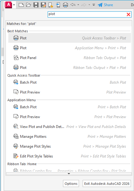

To find all locations from which a command can be accessed
You can find all the places that a command can be accessed in the current workspace.
- Click the Application menu.
- Enter the name of the command in the search box.
If the results refer to a ribbon tab or a ribbon panel that is not displayed, you can display it by following these steps:
- Right-click on any ribbon tab.
- On the shortcut menu, choose Show Tabs or Show Panels, and click the hidden tab or panel that you want to display.
Here's an example of searching for the PLOT command.
