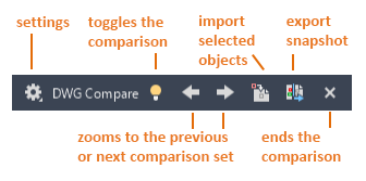

Toolbar Commands and Options
When a compare operation is started, the DWG Compare toolbar displays.
The following controls are available.

Toggle Comparison - On or Off
Toggles the display of the comparison result in the current drawing.
Previous or Next
Zooms into each successive change set in the current drawing.
Import Objects
Starts the COMPAREIMPORT command. When you select objects at the prompt, only those objects that are not already in your current drawing are selectable. This provides a reliable way of limiting the objects being imported to the objects that are unique to the comparison drawing.
Export Snapshot
Starts the COMPAREEXPORT command. Exports the comparison results into a new drawing file, called a snapshot drawing. The DWG Compare Snapshot toolbar displays whenever you open a snapshot drawing.
This toolbar is similar to the DWG Compare toolbar, providing a Settings panel and the Previous and Next controls.
Exit Comparison
Starts the COMPARECLOSE command, which exits the comparison in the current drawing.
