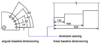

About Controlling Dimension Lines
You can control dimension line properties including color, lineweight, and spacing.
You can control several aspects of a dimension line. You can
  • Specify color and lineweight for visual effect and plotting
  • Suppress the dimension line or, if the dimension line is broken by text, one or both halves
  • Control the spacing between successive dimension lines in baseline dimensions
  • Control the distance by which the dimension line extends beyond the extension lines for architectural tick (oblique stroke) arrowheads
