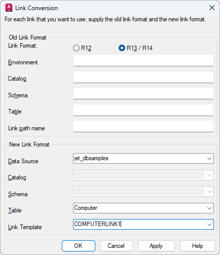

. - In Old Link Format, do all of the following:
- Select R13/R14 Link Format.
- In Environment, enter the name of the Release 13 or Release 14 environment for the link that you want to convert.
- In Catalog, enter the name of the Release 13 or Release 14 catalog for the link that you want to convert.
- In Schema, enter the name of the Release 13 or Release 14 schema for the link that you want to convert.
- In Table, enter the name of the Release 13 or Release 14 database table for the link that you want to convert .
- In Link Path Name, enter the link path name for the link that you want to convert.
- In New Link Format, do all of the following:
- Select the appropriate data source from the Data Source list.
- Select the appropriate catalog from the Catalog list.
- Select the appropriate schema from the Schema list.
- Select the appropriate table from the Table list.
- Select the appropriate link template from the Link Template list.
- Click OK.
- Open the drawing whose links you want to convert, and save it.
