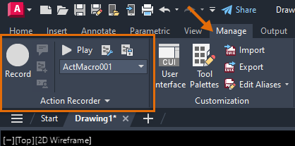

Action macros are recorded using the Action Recorder located on the Manage tab of the ribbon. Think of the Action Recorder as AutoCAD's version of an audio recorder or digital video recorder (DVR).
When recording starts, a red circle appears adjacent to the crosshairs letting you know the Action Recorder is actively listening for actions.

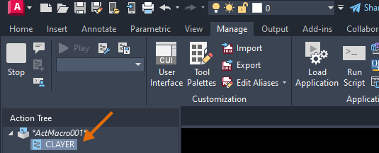

  3. On the ribbon, click Manage tab > Action Recorder panel > Record. Find

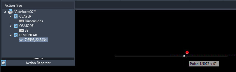

  4. At the Command prompt, enter CLAYER and then enter a name of Dimensions.
    Notice the CLAYER system variable is recorded and shown in the Action Tree.
  5. At the Command prompt, enter OSMODE and then enter a value of 39.
    The value 39 sets the midpoint, endpoint, center, and intersection running object snaps current.

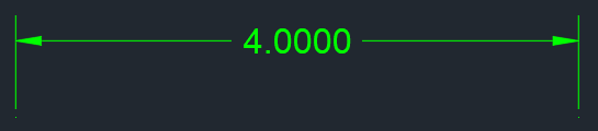

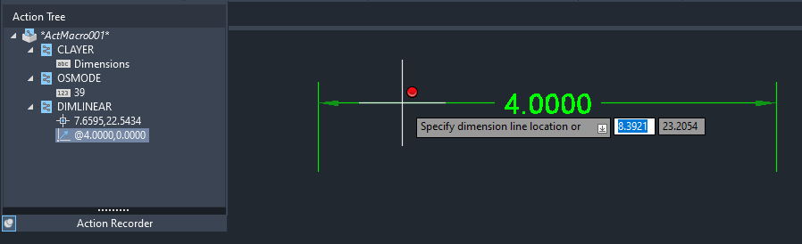

  6. At the Command prompt, enter DIMLINEAR.
  7. At the Specify first extension line origin prompt, specify a point in the drawing.
  8. At the Specify second extension line origin prompt, move the cursor to the right and specify a point.
  9. At the Specify dimension line location prompt, move the cursor up and specify a point.

  11. On the ribbon, click Manage tab > Action Recorder panel > Stop. Find

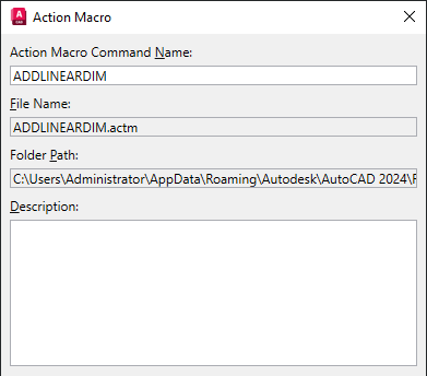

  12. In the Action Macro dialog box, Action Macro Command Name text box, enter ADDLINEARDIM.
  13. Optionally, enter a description for the macro in the Description text box.
  14. Click OK to save the action macro to a file with the ACTM or ACTMX extension based on the release of your product.
    If you expand the Action Record panel, the completed macro should look like the following image.

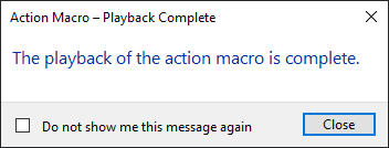

  3. At the Command prompt, enter ADDLINEARDIM.
  4. In the Action Macro – Playback Complete message box, click Close.
    Object snap should now be enabled with a linear dimension drawn on the Dimensions layer.

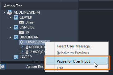

  5. Under the DIMLINEAR command node, right-click over each coordinate value and choose Pause for User Input.
    Each coordinate value should now appear with italic text and have a Silhouette badge overlay. Now during playback, you will be prompted to specify a location for the first and second extension lines along with the dimension line.

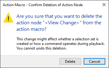

Note: If you notice a <View Change> node in your action macro, you might not need to keep it. A <View Change> node is used to restore the drawing view that was current when the macro was recorded; for example, it might be used to position the in-place text editor into view or the result of a pan/zoom operation.
Before removing a <View Change> node, create a copy of your action macro with the Action Macro Manager dialog box (ACTMANAGER command) and then remove the <View Change> node from the copy of the action macro. Once the action macro has been copied, followed these steps:
  1. If the action macro to edit isn't selected, choose it from the Action Macro drop-down list.
  2. Expand the Action Recorder panel if it isn't already and scroll to the <View Change> node.
  3. Right-click over the <View Change> node and choose Delete.
  4. In the Action Macro – Confirm Deletion of Action Node, click Delete.
  5. Create a new drawing and playback the action macro again.
    This time, the drawing's view shouldn't be changed unless desired.

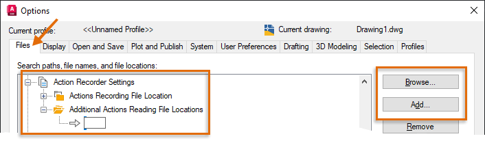

These folder locations are defined under the Action Recorder Settings node on the Files tab of the Options dialog box. The following steps explain how to add an additional location for ACTM and ACTMX files:
  1. In the drawing window, right-click and choose Options.
  2. In the Options dialog box, Files tab, expand the Action Recorder Settings node.
  3. Select the Additional Actions Reading File Locations node.
  4. Click Add and then click Browse.
  5. In the Browse for Folder dialog box, select the folder that contains any additional ACTM and ACTMX files to load into AutoCAD, and click Open (or OK).
  6. Click OK to save the changes made in the Options dialog box.
