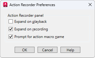

Action Recorder Preferences Dialog Box
Customizes the settings used for the Action Recorder.
List of Options
The following options are available.
Expand on Playback
Expands the Action Tree window whenever playback starts.
Expand on Recording
Expands the Action Tree window whenever recording starts.
Prompt for Action Macro Name
When recording is ended, opens the Action Macro dialog box, where you can assign a name and description to the macro.
