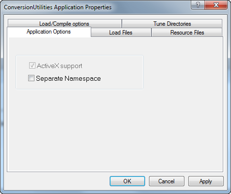

Application Options Tab
Create a separate-namespace VLX and include ActiveX support.
ActiveX Support
Specifies if the AutoLISP ActiveX support functions are automatically loaded with the application.
Separate Namespace
Specifies if the application is ran in its own namespace or in the namespace of the document from which the VLX is loaded.
