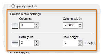

  2. In the Insert Table dialog box, enter 4 columns and 3 data rows. Specify a location for the table.

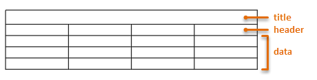

    By default, there are three styles of cells that appear when you use the Standard table style:
  3. Click outside the table, and then select it on an edge to display its grips.
  4. To change the size and shape of the table, click the dark blue triangular grips. You can click the square grips to adjust the width of the columns. You can also use object snap tracking to align the grips to existing geometry.

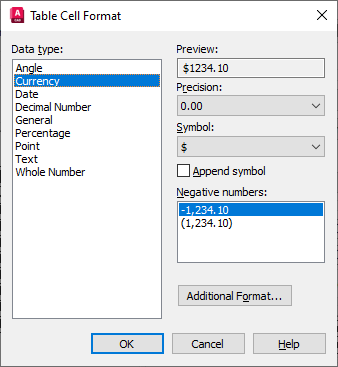

  3. In the same way, click and drag to select the three cells under Price/Unit. Right-click, choose Data Format, and then choose Currency.
  4. Do the same for the data cells under the Quantity and Price headers. For the cells under Quantity, choose Whole Number, and for the cells under Price, choose Currency again.

    If you assigned the data format as Currency, the $ symbol will appear automatically. The $0.00 entries are needed as placeholders for the format. If the values for the currency columns don't display the $ symbol, right click and then choose Data Format to change the cell data format to Currency.

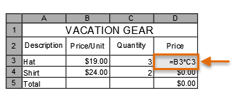

  6. In the first cell under Price (D3), enter =B3*C3. The cells are automatically multiplied.
  7. Similarly, in cell D4, enter =B4*C4.
  8. Next, in cell D5 enter =SUM(D3:D4).
    The colon between D3 and D4 indicates a range of cells between D3 and D4 inclusive.
