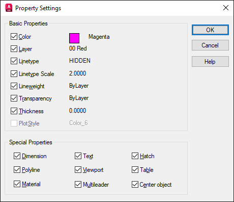

  5. Enter S to select which properties will be copied to the destination objects.
    Some things to note about the property settings:
    • Basic properties are common across all objects.
    • The source object's basic properties are shown in the dialog box.
    • Special properties are properties that are unique to that object type and are applied when the source and destination objects are the same object type.
    Note: In this example, we'll use the Basic Properties. In the next section, we'll look at the Special Properties.

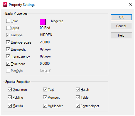

  6. Clear the Color and Layer properties and make sure Linetype and Linetype Scale are selected.
  7. Click OK to exit the Property Settings dialog box.
    Note: The settings are persistent across AutoCAD sessions.
  8. Select the destination objects.
  9. Press Esc or Enter to exit the command.
    Notice that layer and color were not copied to the destination objects.

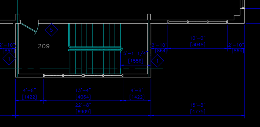

Sometimes you might want to copy properties from an object in one drawing to objects in another drawing. In this example, I'm going to copy properties from a dimension object to a dimension object in another drawing. For this example, we'll need to do some setup and look at the MATCHPROP Special Properties settings.

  2. Select the dimension as the source object on Wall Base.dwg.

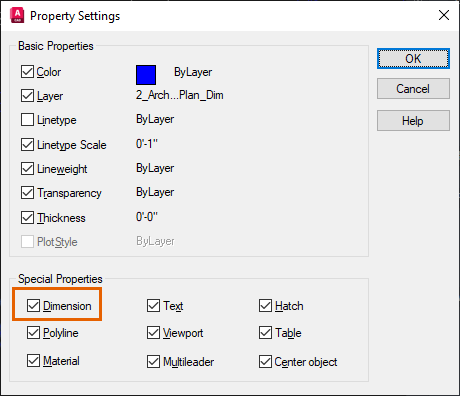

  3. Enter S to open the Property Settings dialog box.
  4. Make sure that Dimension is selected under Special Properties and click OK.
    Special properties apply properties that are specific to the source object type. For dimension objects that includes the dimension style and more.

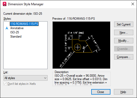

The dimension is updated as expected. But even better, if the dimension style doesn't exist it is created in the drawing! Double-check this by using the DIMSTYLE command. Find
When using MATCHPROP across drawings, any styles or definitions that are needed are created in the drawing. These can include:
  • Dimension style
  • Text style
  • Layer
  • Linetype

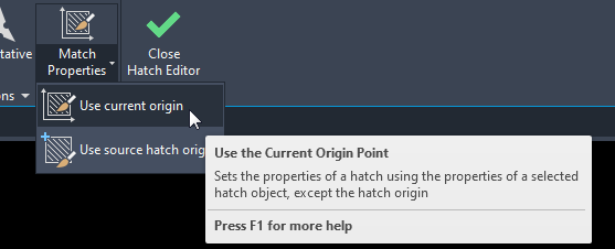

When you use MATCHPROP to copy properties from one hatch object to another, the hatch origin coordinates are also copied. To avoid copying the origin, use the following steps.
  1. Open a drawing which contains multiple hatch objects or create them similar to what is shown here.
  2. Select the hatch that you want to change, that is the one you want to copy the properties to.
    Note: This might seem backwards since you are really selecting the destination object first.
    The Hatch Editor contextual ribbon displays.
  3. Select Use Current Origin from the Match Properties drop-down.
  4. Select the hatch object with the properties that you want to copy.
    This is considered the source object. The properties are copied to the hatch being edited.
