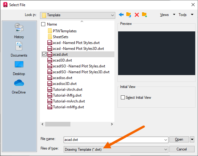

To make a change to a template, you'll need to open it. Opening a template is like opening a drawing.
  1. Choose Open from the Quick Access Toolbar.
    Or at the Command prompt type, open.
  2. In the Files of type drop-down list, choose Drawing Template (*.dwt).
    You should see the templates installed with AutoCAD.
  3. Select a template and click Open. For this exercise, we'll select acad.dwt.
  4. Note: Changing the template only affects new drawings, and does not affect any drawings that were previously created using that template.
    The template name appears on a drawing tab with a .dwt extension and is ready for editing.

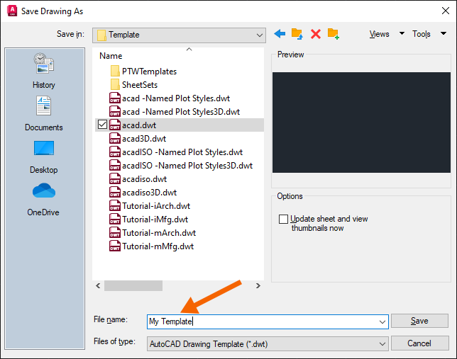

    Saving and closing a template is like saving a drawing. Click Save or Save As from the Quick Access Toolbar to save the template and keep working.
  5. For this exercise, I'll create a new template by clicking Save As and give the template a name, MyTemplate, and click Save.
  6. In the Template Options dialog box, enter a description for the template and leave the rest of the defaults as they are and click OK.

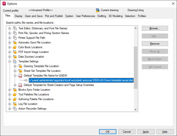

Now that you have a template created and saved, let's start using it. By default, when you start a new drawing, AutoCAD creates the drawing from the template specified in the Default Template File Name for QNEW, in this case, acad.dwt. Let's change this setting to start a new drawing using the new template.
  1. In the drawing window, right-click and choose Options.
    Or at the Command prompt type, options.
  2. Click the Files tab and expand Template Settings > Default Template File Name for QNEW.
  3. Select the file path and choose Browse.
    Or double-click the file path to browse.
    Note: None is the default option for Default Template File Name for QNEW. When it's set to None the QNEW command acts like the NEW command.

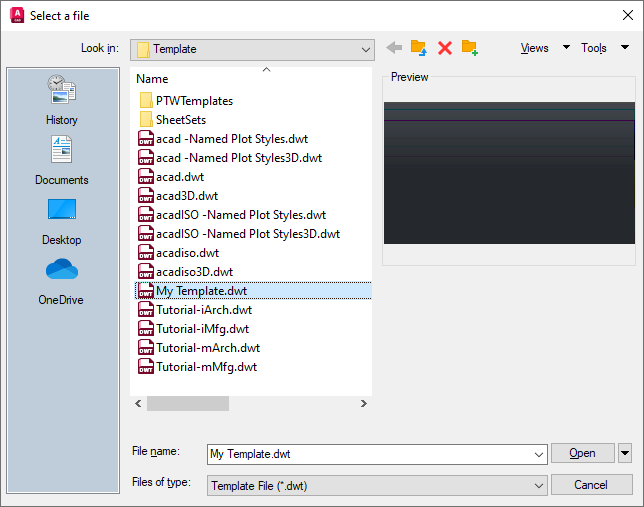

  4. From the Select a file dialog box, browse to and select the template file you want AutoCAD to use as the default for a new drawing, in this case MyTemplate, and click Open.
  5. Click OK to close the Options dialog box.
    Now when you start a new drawing, AutoCAD will use MyTemplate.

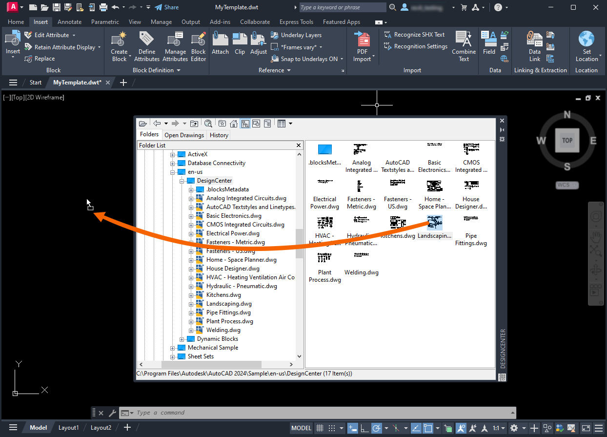

DesignCenter can be used to add layers, named styles, and blocks, to a template.
  1. In this exercise, open MyTemplate.dwt.
  2. Click View tab > Palettes panel > DesignCenter Find
    Or at the Command prompt, type adcenter.
  3. Add the layers, blocks, and styles from Landscaping.dwg to the template.
  4. In DesignCenter, navigate to Landscaping.dwg and drag the drawing into the drawing area of the template.

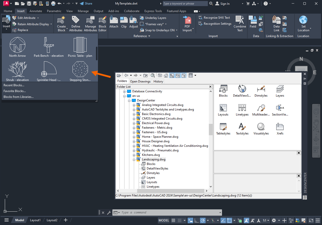

Note: If you only want the block definitions available to insert from the Blocks palette press Esc after the drag and drop. Otherwise, the blocks will be inserted into the template drawing window.
Now the named styles, blocks, and drawing settings that are defined in Landscaping.dwg are now available in MyTemplate.
Create a new drawing to test MyTemplate and verify the blocks are available in the new drawing.
