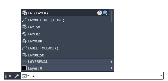

Display Suggested Commands and System Variables
By default, the name of a command or system variable is automatically completed as you type it. A suggestion list of commands and system variables that use the same letters is also displayed. You can control the settings for these features in the Input Search Options dialog box.
If the automatic completion features are turned off, type a letter on the command line and press the Tab key to cycle through all the commands and system variables that begin with that letter. Press Enter or Spacebar to start the command or system variable.
Enter Command Aliases
Some commands have abbreviated names, or command aliases, that you can enter at the command line. For example, instead of entering circle to start the CIRCLE command, you can type c and press Enter. The command Suggestion List (if displayed) indicates the alias in front of the command name: C (CIRCLE)

  • Automatic completion. Completes name of a command or system variable as you type it.
  • Command line suggestion list. Displays a list of commands or system variables that match or contain the letters you have typed. The order of this list changes as you use the program, so that the commands you use most frequently are displayed at the top of the list. The program also offers suggestions for misspelled entries.

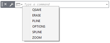

  • Command cycling. Cycles through commands you have already used in the current session when you press the Arrow keys. An arrow button on the left end of the command line also displays this list.
You can change the settings for these options from the command line Customization button or shortcut menu.
