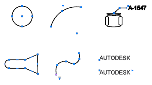

Grips are small squares, rectangles, and triangles that appear on selected objects. You can stretch, move, copy, rotate, scale, and mirror objects using grips without having to enter any commands.

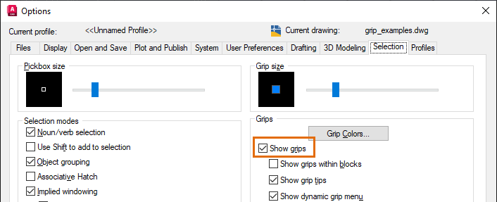

  1. Right-click in the drawing area and select Options.
  2. In the Options dialog box, Selection tab, make sure that Show Grips is selected.

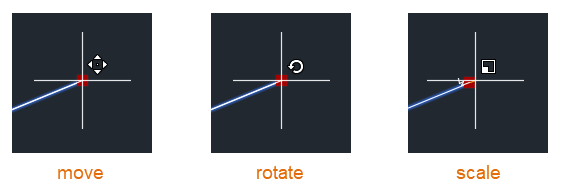

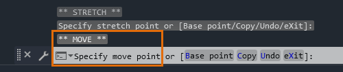

  4. Press the Spacebar.
    Notice that the command prompt now shows you're in the move mode.
    Note: Cursor badges indicate when you are in move, rotate, or scale grip modes but not stretch or mirror.
  5. Move the cursor around and the line moves with it.
    Again, until you specify a destination point the action is temporary. You can press ESC at any time to exit the action.

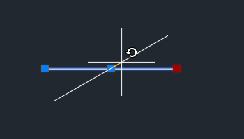

    Notice that the line is rotating around the endpoint where you selected the grip. But let's say you wanted to rotate it around the midpoint of the line.
  4. Type B and press the Spacebar to select the base point option.
  5. Select the midpoint grip as the new base point.
    Note: You may need to press F3 to turn object snaps off.
  6. Rotate the line.

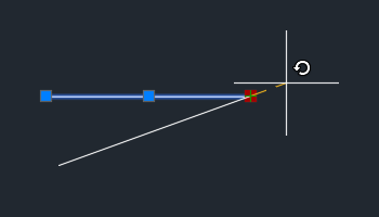

  4. Press the Spacebar until the rotate grip mode is active.

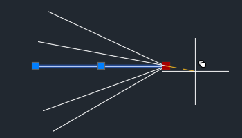

  5. Type C and press the Spacebar to copy the object as you rotate it.
  6. Enter 30 as the first rotation angle.
  7. Enter 20 as the next angle.
    Notice the line is rotated and copied from the original line, not the previous copy.
  8. Enter -25 for the next angle.
  9. Press Esc to exit.

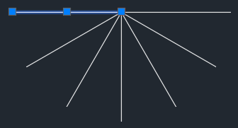

    This becomes the angle for the rotation snap for each copy.
  7. Hold down the Ctrl key and drag the cursor to create more copies.
    Your cursor snaps to 30-degree angles as you drag it.
  8. Keep Ctrl pressed and continue clicking until you create several lines rotated from the original line at 30-degree increments.
    Note: Experiment with pressing the Ctrl key and making a few copies, releasing the Ctrl key and making a few more copies, and finally pressing the Ctrl key again for a few more copies. Pressing the Ctrl key will snap to the angle used right before pressing Ctrl.

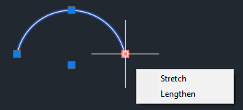

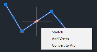

Instead of selecting a grip as in the previous exercise, just hover the cursor over a grip. A menu displays with actions associated with the grip. Depending on the object selected, and the grip, the menu options will vary. Not all grips have grip menus. Grips with menus are called multifunctional grips.

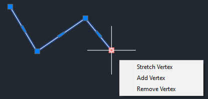

  1. Draw a polyline with at least three segments.
  2. Select the polyline.
  3. Hover the cursor over one of the end grips to see the grip menu.
  4. Hover the cursor over one of the segment's midpoint grips to see its grip menu.
  5. Click a menu option and try it. Press Esc to exit.
  6. Try this again with an arc.
  7. And finally, with a hatch object.
Note: If you select the grip, you can press Ctrl to cycle through the grip menu options.
