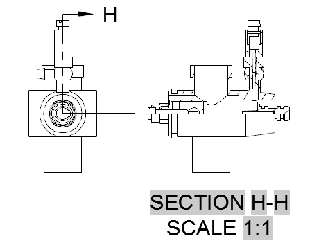

To Create a Half Section View
You generate a half section view by running the cutting plane through a portion of the length of the object being sectioned.
  1. Click Layout tabCreate View panelSection drop-downHalf. Find
  2. Click the view you want to use as the parent view. The start direction arrow appears at the cursor.
  3. Click in the drawing area to indicate the start point of the section line. The end direction arrow appears at the cursor.
    Tip:
    • Use object snaps, object snap tracking, ortho and polar tracking to specify the location of the section line precisely.
    • If the CONSTRAINTINFER system variable is 1, the section line is automatically constrained to the parent view.
  4. Click in the drawing area to indicate end point of the first segment of the section line.
  5. Click in the drawing area to indicate the end point of the section line. A preview of the section view appears at the cursor.
    Tip: You can modify the properties of the section view using the Section View Creation ribbon contextual tab.
  6. Move the preview to the desired location and click to place the view.
    Tip: The preview is constrained to move in a direction perpendicular to the section line. To relax the constraint, tap SHIFT. To restore the constraint, tap SHIFT again.
  7. Click Section View Creation tabCreate panelOK.
