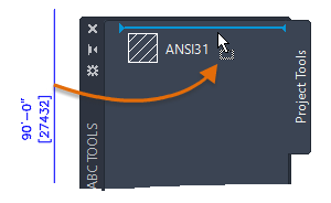

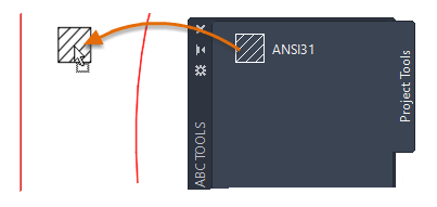

  4. In the drawing area, select a hatch object.
  5. Press and hold the right mouse button, drag the hatch object onto the tool palette.
    That’s all there is to it, you just created a tool based on the selected hatch object.
  6. On the Tool Palettes window, click the new hatch tool and pick a point (or drag and drop the hatch tool) within an enclosed area to apply a hatch pattern.
    The new hatch object includes all the property settings from the original hatch.

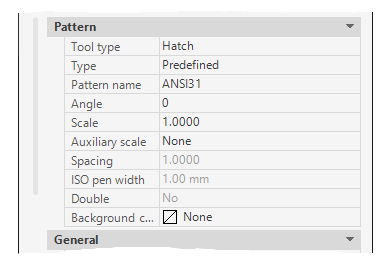

Tip: Right-click on a hatch tool and choose Properties to display the Tool Properties dialog box and edit the tool's properties.

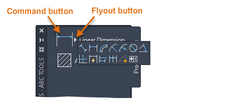

A dimension tool can be created by dragging a dimension object onto a tool palette. When a new dimension tool is created, the tool contains a flyout button.

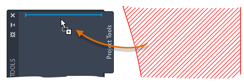

  2. In the drawing area, select a dimension object.
  3. Press and hold the right mouse button and drag the dimension object onto the tool palette.

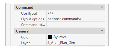

  4. Right-click the new dimension tool on the tool palette and choose Properties to edit its properties and behavior.
    1. In the Tool Properties dialog box, under the Command section, you can edit the properties that control the behavior of the dimension tool.
      • Use Flyout – Enables the display of a flyout button for the tool.
      • Flyout Options – Controls which commands are displayed when the flyout menu is displayed.
      • Command String – Includes the command macro to run when the tool is clicked. This option is available only when the Use Flyout option is turned off.
    2. Under the General section, edit the general properties to be applied to new dimension objects created with the tool.
    3. When you are done making changes, click OK.

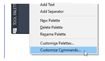

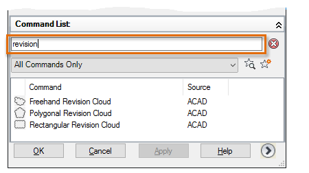

  1. With the Tool Palettes window displayed, right-click its title bar or in an empty area near a tool and choose Customize Commands.
  2. In the Customize User Interface (CUI) Editor, under the Command List pane, click in the Search Command List text box and type revision.

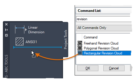

  3. In the Commands List, drag the Rectangular Revision Cloud command onto the tool palette.
  4. Close the CUI Editor.

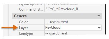

  5. On the Tool Palettes window, right-click the Rectangular Revision Cloud tool and choose Properties.
  6. In the Tool Properties dialog box, under the General section, click the Layer property and choose the layer to be set current when you use the tool.
    Note: The layer must already exist in the current drawing before it can be assigned to the tool. When the tool is used in a drawing that doesn’t contain the assigned layer, the layer is automatically created before it runs the command.
  7. Click OK to apply the change.
