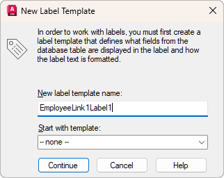

To work with labels, you must first create a label template that defines what fields from the database table are displayed in the label and how the label text is formatted.

After defining a label template, you might have cause to edit it. For example, you may decide that you want additional database table fields to be displayed in your drawings, or that you want to change the font or size of the label object. You can also specify a number of offset settings that affect the insertion point of labels and, in the case of attached labels, their associated leader objects.
The Label Offset tab of the Label Template dialog box specifies X and Y coordinate offset values for labels and leader objects. The following table summarizes the effect these settings have on both freestanding and attached labels.
