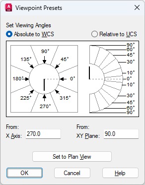

Viewpoint Presets Dialog Box
VPOINT (Command)
List of Options
The following options are displayed.
Set Viewing Angles
Sets the direction of the view relative to either the world coordinate system (WCS) or a user coordinate system (UCS).
Absolute to WCS
Sets the view direction relative to the WCS.
Relative to UCS
Sets the view direction relative to the current UCS.
From
Specifies viewing angles.
X Axis
Specifies the angle from the X axis.
XY Plane
Specifies the angle from the XY plane.
You can also use the sample image to specify viewing angles. The black arm indicates the new angle. The gray arm indicates the current angle. Specify an angle by selecting the inner region of the circle or half-circle. Selecting the bounded outer regions rounds off the angle to the value displayed in that region. If you select the inner arc or an area inside it, the angle is not rounded off, and the result may be a fractional number.
Set to Plan View
Sets the viewing angles to display the plan view (XY plane) relative to the selected coordinate system.
