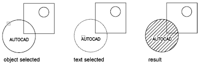

Select
Specifies a hatch boundary based on selected objects.
When you use this option, interior objects are not detected automatically. You must select the objects within the selected boundary to hatch or fill those objects according to the current island detection style.
In order to create an unhatched space around text, include the text in the selection set.
While selecting objects, you can right-click at any time in the drawing area to display a shortcut menu. You can undo the last selection or all selections, change the selection method, change the island detection style, or preview the hatch or fill.
