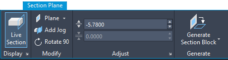

Section Plane Ribbon Contextual Tab
Enables live sectioning, modifies section plane properties, and generates blocks from sections.
When you select a section line, the Section Plane contextual tab is displayed on the ribbon.
Display panel
Live Section
Turns on live sectioning for a selected section object.
Section Plane Settings
Sets display options for the selected section plane.
Modify panel
Section object type
Displays a list of section object types available.
  • Plane. The section line and transparent section plane indicator are displayed. The cutting plane extends infinitely in all directions.
  • Slice. A 2D box shows the depth along the direction of the cutting plane.
  • Boundary. A 2D box shows the XY extents of the cutting plane. The cutting plane along the Z axis extends infinitely.
  • Volume. A 3D box shows the extents of the cutting plane in all directions.
Add Jog
Adds a jogged segment to a section object.
Rotate 90
Rotates the section object 90 degrees around the section line.
Adjust Slice panel
Section Offset
Moves the section object perpendicular to the section plane towards or away from the WCS origin.
Slice Thickness
Increases of decreased the slice thickness of the section object.
Section Panel Spinner Control dialog box
Sets the default increment or decrement unit value for the Section Offset and the Slice Thickness controls in the Adjust panel of the ribbon.
Generate panel
Generate Section Block
Saves selected section planes as 2D or 3D blocks.
Extract Section Lines
Creates 2D geometry from a point cloud for the active section plane.
