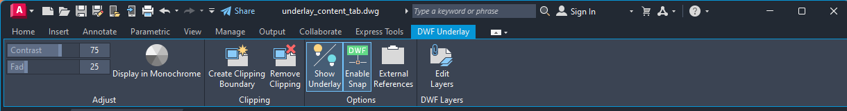

Change DWF underlay display, clip, layer, and osnap options.
When you select a DWF underlay in a drawing, the DWF Underlay Contextual tab is displayed on the ribbon.
List of Panels
Adjust Panel
Contrast
Controls the contrast and the fading effect of the underlay. The greater the value, the more each pixel is forced to its primary or secondary color.
Fade
Controls the appearance of linework. The greater the value, the lighter the linework in the underlay appears.
Display in Monochrome
Displays the underlay in black and white.
Clipping Panel
Create Clipping Boundary
Deletes the old clipping boundary (if one exists) and creates a new one.
Remove Clipping
Deletes the clipping boundary.
Options Panel
Show Underlay
Hides or displays the underlay.
Enable Snap
Determines whether object snapping is active for geometry in the DWF underlay.
External References
Displays the External References palette.
DWF Layers Panel
Edit Layers
Controls the display of layers in a DWF Underlay.
