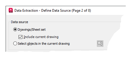

  5. Use the Drawings/Sheet Set and Include Current Drawing options, and click Next to continue.

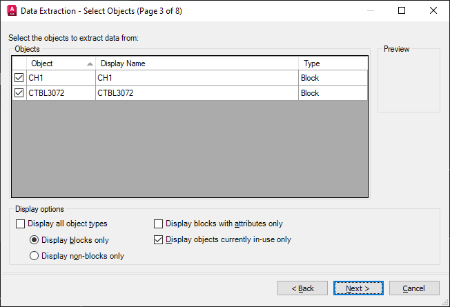

  6. Clear the Display All Object Types checkbox and choose Display Blocks Only, and click Next to continue.

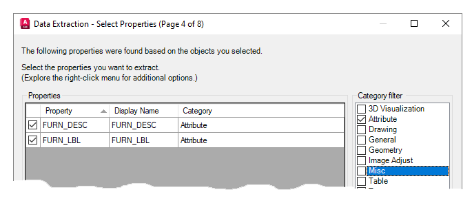

  7. Under Category Filter, clear all options except Attribute and then make sure the properties checked match the attribute values to extract.
  8. Double-click the Display Name field for each attribute and change its value to match the previous image. Click Next to continue.

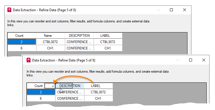

  9. On the Refine Data page, reorder, rename and hide columns to control the extracted output. Click Next to continue.

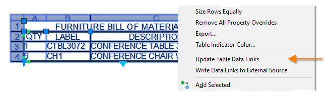

  2. Select the table that contains the extracted data, right-click and choose Update Table Data Links.
    The following shows the results of updating the extracted data in a table after adding some additional blocks to a drawing.

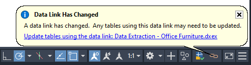

Tip: When at least one table in a drawing contains extracted data, the Data Links icon is displayed in the system tray of the AutoCAD application window. While the icon is displayed, you can right-click the icon to manage and update the data links in a drawing. The DATALINKNOTIFY system variable controls the appearance and functionality of the Data Links icon.
