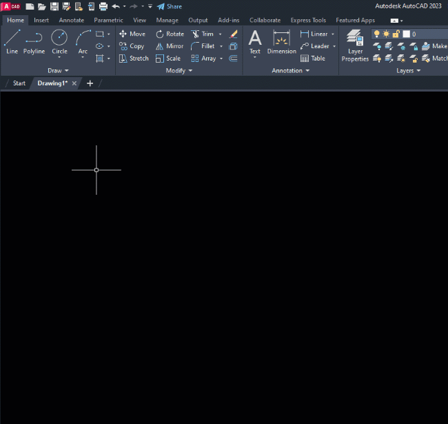

To Change the Background and Other Color Settings
  1. Click Application button > Options.
  2. In the Options dialog box, Display tab, click Colors.
  3. In the Drawing Window Colors dialog box, select the context and the interface element that you want to change.
  4. On the Color list, select the color that you want to use.
    To specify a custom color, click Select Color at the bottom of the list.
    To revert to the default color settings, click the appropriate Restore button.
