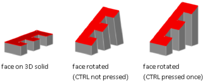

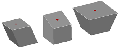

As you drag a face, press Ctrl to cycle through modification options.
  • Extend Adjacent Faces. When you move or rotate a face without pressing Ctrl, the shape and size of the face is maintained. However, the planes of adjacent faces might change.
  • Move Face.When you move a face and press and release Ctrl once while dragging, the position of the face is modified within the boundary, or footprint, of the adjacent faces.
  • Allow Triangulation.When you move or rotate a face and press and release Ctrl twice while dragging, the size and shape of the face is maintained. (This behavior is the same as if you had not pressed Ctrl). However, the adjacent planar faces are triangulated (divided into two or more planar triangular faces), if necessary.
If you press and release Ctrl a third time, the modification returns to the first option, as if you had not pressed Ctrl.
