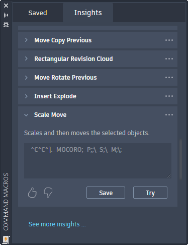

Opens the Command Macros palette from which you can manage and use command macro recommendations.
Find
The Command Macros palette displays previously saved and new command macro recommendations identified based on the command sequences you executed in the product.
List of Tabs
- Saved
Contains the command macros previously saved from the Insights tab.
From this tab, you can:
- Run a saved command macro
- Add a macro to the Automation ribbon tab
- Edit a saved command macro with the Command Macro Editor or the Customize User Interface (CUI) Editor
- Rename or remove a saved command macro
- Insights
Lists the latest received macro insights based on matches to the command sequences you executed in the product.
- View the description of and command macro string associated with a macro insight
- Save a macro insight as a command macro to the Saved tab
- Try the command macro associated with a macro insight
- Provide feedback by liking or dismissing a macro insight
- See other available insights based on your product usage
