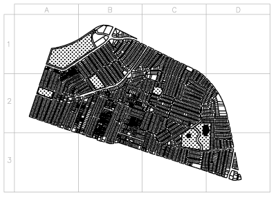

By organizing large drawings into sectored views, you can load and edit only what you need. For example, if you work with a city plan and need to edit only the southeast sector (sector D3 in the illustration), you can load this drawing area by specifying the predefined view. If you need to edit the city plot numbers only, you can load the geometry on this specific layer.
