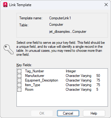

To Create a Link Template in the Current Drawing
  1. Click Tools menu PalettesDbConnect.
  2. In the dbConnect Manager, right-click a data source file and choose New Link Template.
  3. Enter a name for the link template and click Continue.
  4. Select one or more key fields by clicking in their check boxes.
    Attention: Selecting a large number of key fields can adversly affect the performance of Link Select and other connectivity operations.
  5. Click OK to create the link template.
