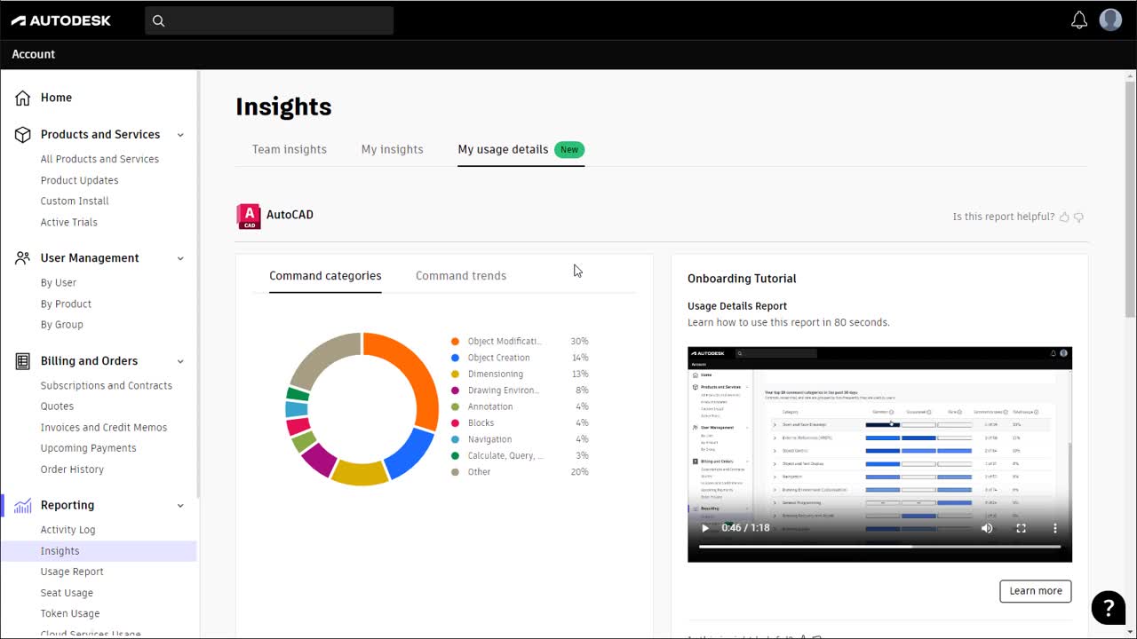

My Usage Details
The My Usage Details report summarizes your personal usage of AutoCAD by commands and command categories.
  • Commands - Tools and commands that you used in AutoCAD and the number of times each has been used
  • Categories - Groupings of commands based on related skills or workflows
Command Categories
The chart displays your command usage by category in the past 30-days. Click on a segment in the chart to view the top commands in that specific category.
Skill Tree for AutoCAD: Command Categories image
The chart displays the trend of your command usage over the past 6 months. It is broken down by the common, occasional, and rare types. The y-axis of the chart shows the total count of commands used, not the unique commands. If you used the LINE command 100 times, it would count as 100 in this chart.
An upward trend might indicate using or learning more commands. A downward trend might indicate using fewer or more efficient commands.
Skill Tree for AutoCAD: Command Trends image
Common, Occasional, and Rare
We further break down commands based on how frequently they're used among all AutoCAD users. This classification is not a direct reflection of your personal usage, but that of the broader community. This will allow you to compare your usage patterns to others to discover new commands.
  • Common - Frequently used commands among AutoCAD users
  • Occasional - Periodically used commands among AutoCAD users
  • Rare - Infrequently used commands among AutoCAD users, typically used in specialized workflows
Top Categories
The table displays details about your Top 10 command categories in the past 30-days; frequency of use by type, commands used, and total usage.
  • Frequency of use by type - The colored boxes represent your frequency of commands used for each category and type. Dark blue indicates more frequent use, while light blue signals less frequent use. Grey indicates no usage.
  • Commands used - Commands used out of all the commands in the category. This is a count of unique commands rather than total times used.
  • Total usage - Percentage of use out of all the categories you've used.
Click on a row to see more information about the commands within that category. Commands are displayed by type along with the number of commands used. Each command is represented by a box. The color of the box represents your frequency of use. Dark blue indicates more frequent use, while light blue signals less frequent use. Grey indicates unused commands.
Some users might see commands inside categories marked with a green dot. These are personalized recommendations for you that similar users have found useful.
Skill Tree for AutoCAD: Top Categories image
