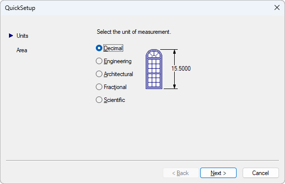

The Quick Setup wizard has two pages: Units and Area. As you work in this wizard, choose Back and Next to switch between pages; choose Finish on the last page to close the wizard and create the new drawing with the settings you specified.
Units
Indicates the format in which you enter and in which the program displays coordinates and measurements. Several formats are available. Engineering and Architectural have a specific base unit (inches) assigned to them. You can select from other measurement styles that can represent any convenient unit of measurement.
Note: You control the precision (the number of decimal places displayed in all measurements) by using the Advanced Setup wizard or the UNITS command. The default precision used by Quick Setup is four (0.0000).
Decimal
Displays measurements in decimal notation.
Engineering
Displays measurements in feet and decimal inches.
Architectural
Displays measurements in feet, inches, and fractional inches.
Fractional
Displays measurements in mixed-number (integer and fractional) notation.
Scientific
Displays measurements in scientific notation (numbers expressed in the form of the product of a decimal number between 0 and 10 and a power of 10).
