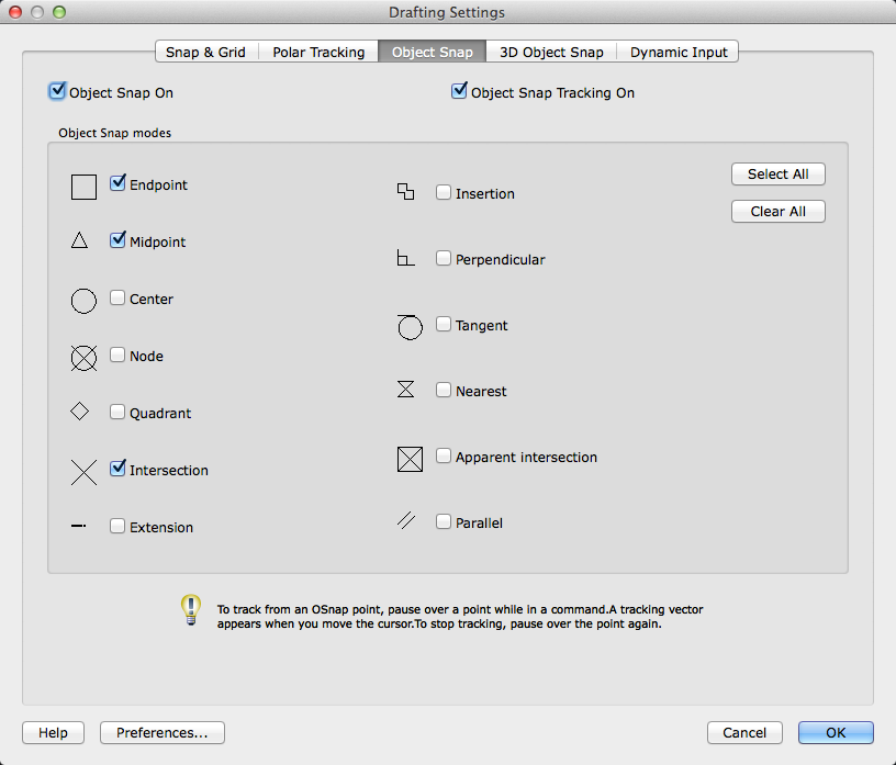

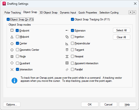

  2. At the Command prompt, enter osnap.
    The Drafting Settings dialog box is displayed with the Object Snap tab current. This tab allows you to see which object snaps are enabled. The following image shows what the Drafting Settings dialog box looks like when the OSMODE system variable is set to a value of 35.
    Drafting Settings dialog box - Windows
    Drafting Settings dialog box - Mac OS
  3. In the Drafting Settings dialog box, change which object snaps are current and click OK.
  4. At the Command prompt, enter (getvar "osmode").
    The current value of the OSMODE system variable is returned.
  5. At the Command prompt, enter (setvar "osmode" cur_osmode).
    The value of the OSMODE system variable is restored to the value that was previously assigned to the user-defined variable cur_osmode.
  6. Display the Drafting Settings dialog box again. You should see that the object snap settings have been restored.
