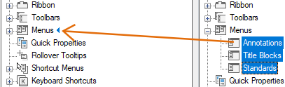

  6. In the left pane, click the plus sign (+) next to an interface element node to expand it. Expand the corresponding node in the right pane.
  7. Drag user interface elements from the right pane to the appropriate location in the left pane, and drop the user interface elements to create a copy of the elements.
    Note: User interface elements can be dragged in either direction; left to right or right to left.
