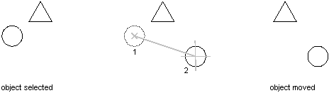

You can move all drawing objects and attribute reference objects along a specified vector.
To move an object, use the Move method provided for that object. This method requires two coordinates as input. These coordinates define a displacement vector indicating how far the given object is to be moved and in what direction.
Move a circle along a vector
This example creates a circle and then moves that circle two units along the X axis.
