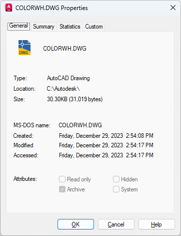

General Tab (Drawing Properties Dialog Box)
Displays read-only information about the drawing file, which is derived from the operating system.
DWGPROPS (Command) Find
List of Options
The following options are displayed.
File Name
Shows the file icon and the file name.
File Type, Location, Size
Shows the file type, the file location, and the size of the file.
MS-DOS Name, Created, Modified, Accessed
Shows MS-DOS name, when the file was created, and the date and time it was last modified and last accessed.
Attributes
Shows system-level file attributes. These values can be modified in File Explorer.
Read-Only
Indicates that the file is read-only; it cannot be changed or deleted accidentally.
Archive
Indicates that this file should be archived. This setting is used to determine which files should be backed up.
Hidden
Indicates that the file is hidden; you cannot see or use it unless you know its name.
System
Indicates that the file is a system file. A drawing cannot have the System attribute set.
