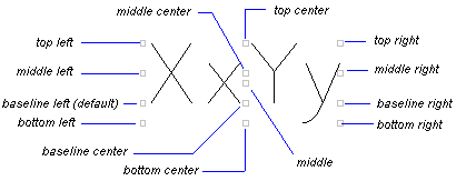

Specifies both the vertical and horizontal alignments for the attribute, attribute reference, or text.

Type: acAlignment enum
  • acAlignmentLeft
  • acAlignmentCenter
  • acAlignmentRight
  • acAlignmentAligned
  • acAlignmentMiddle
  • acAlignmentFit
  • acAlignmentTopLeft
  • acAlignmentTopCenter
  • acAlignmentTopRight
  • acAlignmentMiddleLeft
  • acAlignmentMiddleCenter
  • acAlignmentMiddleRight
  • acAlignmentBottomLeft
  • acAlignmentBottomCenter
  • acAlignmentBottomRight
Remarks
Text aligned to acAlignmentLeft uses the InsertionPoint property to position the text.
Text aligned to acAlignmentAligned or acAlignmentFit uses both the InsertionPoint and TextAlignmentPoint properties to position the text.
Text aligned to any other position uses the TextAlignmentPoint property to position the text.
