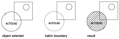

Choose from several methods to specify the boundaries of a hatch.
  • Specify a point in an area that is enclosed by objects.
  • Select objects that enclose an area.
  • Specify boundary points using the -HATCH Draw option.
  • Drag a hatch pattern into an enclosed area from a tool palette or DesignCenter.
The following prompts are displayed.
Pick internal point
Determines a boundary from existing objects that form an enclosed area around the specified point.
Select objects
Determines a boundary from selected objects that form an enclosed area.
