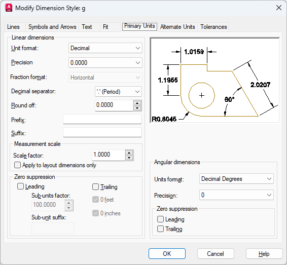

Primary Units Tab (Dimension Style Manager)
Sets the format and precision of primary dimension units and sets prefixes and suffixes for dimension text.
List of Options
The following options are displayed.
Linear Dimensions
Sets the format and precision for linear dimensions.
Unit Format
Sets the current units format for all dimension types except Angular. (DIMLUNIT system variable)
The relative sizes of numbers in stacked fractions are based on the DIMTFAC system variable (in the same way that tolerance values use this system variable).
Precision
Displays and sets the number of decimal places in the dimension text. (DIMDEC system variable)
Fraction Format
Sets the format for fractions. (DIMFRAC system variable)
Decimal Separator
Sets the separator for decimal formats. (DIMDSEP system variable)
Round Off
Sets nearest rounding value for dimension measurements for all dimension types except Angular. (DIMRND system variable)
If you enter a value of 0.25, all distances are rounded to the nearest 0.25 unit. If you enter a value of 1.0, all dimension distances are rounded to the nearest integer. Take note that the number of digits displayed after the decimal point depends on the Precision setting.
Prefix
Includes a prefix that you specify in the dimension text. (DIMPOST system variable)
You can enter text or use control codes to display special symbols. For example, entering the control code %%c displays the diameter symbol. When you enter a prefix, it overrides any default prefixes such as those used in diameter and radius dimensioning.
If you specify tolerances, the prefix is added to the tolerances as well as to the main dimension.
For more information, see Control Codes and Special Characters.
Suffix
Includes a suffix that you specify in the dimension text. (DIMPOST system variable)
You can enter text or use control codes to display special symbols. For example, entering the text mm results in dimension text similar to that shown in the illustration. When you enter a suffix, it overrides any default suffixes.
If you specify tolerances, the suffix is added to the tolerances as well as to the main dimension.
Measurement Scale
Defines linear scale options. Applies primarily to legacy drawings.
Scale Factor
Sets a scale factor for linear dimension measurements. It is recommended that you do not change this value from the default value of 1.00. (DIMLFAC system variable)
For example, if you enter 2, the dimension for a 1-inch line is displayed as two inches. The value does not apply to angular dimensions and is not applied to rounding values or to plus or minus tolerance values.
Apply to Layout Dimensions Only
Applies the measurement scale factor only to dimensions created in layout viewports. Except when using nonassociative dimensions, this setting should remain unchecked. (DIMLFAC system variable)
Zero Suppression
Controls the suppression of leading and trailing zeros and of feet and inches that have a value of zero. (DIMZIN system variable)
Zero suppression settings also affect real-to-string conversions performed by the AutoLISP® rtos and angtos functions.
Leading
Suppresses leading zeros in all decimal dimensions. For example, 0.5000 becomes .5000. Select leading to enable display of dimension distances less than one unit in sub units.
Sub-units factor
Sets the number of sub units to a unit. It is used to calculate the dimension distance in a sub unit when the distance is less than one unit. For example, enter 100 if the suffix is m and the sub-unit suffix is to display in cm.
Sub-unit suffix
Includes a suffix to the dimension value sub unit. You can enter text or use control codes to display special symbols. For example, enter cm for .96m to display as 96cm.
Trailing
Suppresses trailing zeros in all decimal dimensions. For example, 12.5000 becomes 12.5, and 30.0000 becomes 30.
0 Feet
Suppresses the feet portion of a feet-and-inches dimension when the distance is less than one foot. For example, 0'-6 1/2" becomes 6 1/2".
0 Inches
Suppresses the inches portion of a feet-and-inches dimension when the distance is an integral number of feet. For example, 1'-0" becomes 1'.
Angular Dimensions
Displays and sets the current angle format for angular dimensions.
Units Format
Sets the angular units format. (DIMAUNIT system variable)
Precision
Sets the number of decimal places for angular dimensions. DIMADEC system variable)
Zero Suppression
Controls the suppression of leading and trailing zeros. (DIMAZIN system variable)
Leading
Suppresses leading zeros in angular decimal dimensions. For example, 0.5000 becomes .5000.
You can also display dimension distances less than one unit in sub units.
Trailing
Suppresses trailing zeros in angular decimal dimensions. For example, 12.5000 becomes 12.5, and 30.0000 becomes 30.
