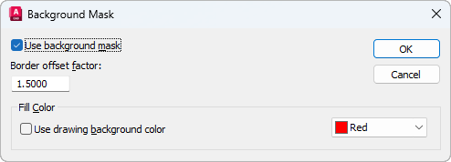

Background Mask Dialog Box
MTEXT (Command) Find: Right-click in the in-place text editor > Background Mask
List of Options
The following options are displayed.
Use Background Mask
Puts an opaque background behind the text.
Note: When you apply a background mask to text multiple columns only the column areas will be masked. The space between the columns commonly referred to as gutters will be unmasked.
Border Offset Factor
Specifies the margin around the text for the opaque background. The value is based on the text height. A factor of 1.0 exactly fits the multiline text object. A factor of 1.5 extends the background by 0.5 times the text height.
Fill Color
Specifies the color for the background.
Use Background Drawing Color
Provides a background that is the same color as the background of the drawing.
Color
Specifies a color for the opaque background. You can select one of the colors in the list or click Select Color to open the Select Color dialog box.
