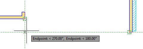

Snap to a Location Based on Two Other Locations
Use object snap tracking to select a point along alignment paths that are based on object snap points. Alignment paths can be horizontal, vertical, parallel, or to a preset polar tracking angle.
  1. Press F11 to turn on object snap tracking.
  2. At a prompt for a point, hold down Shift and then right-click in the drawing area. Choose the object snap that you want to use.
  3. Move your cursor over an object snap location.
    Acquired points display a small plus sign (+).
  4. Move your cursor. Alignment paths that are relative to the acquired point display as you move the cursor.
  5. Move your cursor over a second object snap location.
  6. Move your cursor until the tracking path displays and intersects with the previous alignment path.
  7. Click to specify the combined location.

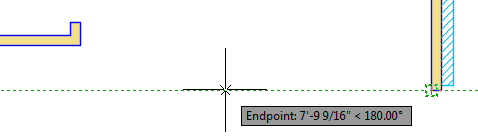

Snap to a Location by Tracking Along an Angle and Entering a Distance
Polar tracking guides the movement of your cursor to specified polar angles and angle increments.
  1. Define the polar tracking settings.
    1. On the status bar, right-click Polar Tracking. Find
    2. From the menu that displays, click Tracking Settings.
    3. In the Drafting Settings dialog box, Polar Tracking tab, turn on polar tracking.
    4. Specify the polar tracking angles, incremental and additional, and other settings as needed.
  2. Start a command, for example click Home tab Draw panel Line. Find
  3. Specify the start point.
  4. At a prompt for a point, move the cursor near the desired angle.
    The cursor snaps to the angles and increments defined in the polar tracking settings.
  5. Enter a distance from the start point, for example 2.25.
