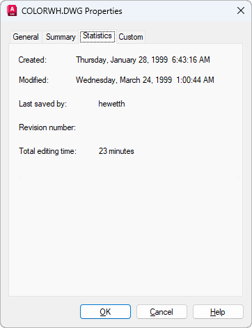

Statistics Tab (Drawing Properties Dialog Box)
DWGPROPS (Command) Find
These file properties can help you search for drawings created or modified during a specific period.
Note: If the drawing was last saved using an application other than Autodesk software, a warning message is displayed. Display of the warning message is controlled by the DWGCHECK system variable.
List of Options
The following options are displayed.
Created
Displays the date and time the drawing was created. This value is stored in the TDCREATE system variable.
Modified
Displays the date and time the drawing was last modified. This value is stored in the TDUPDATE system variable.
Last Saved By
Displays the name of the last person who modified the file.
The Last Saved By name is stored in the LOGINNAME system variable. (Not available for AutoCAD LT.)
Revision Number
Displays the revision number. This value is not accessible. To track revisions, create a custom property on the Custom tab.
Total Editing Time
Displays the total amount of editing time in the drawing. This value is stored in the TDINDWG system variable.
