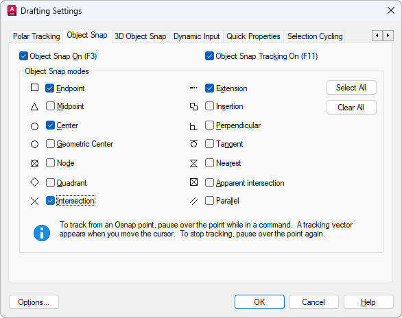

With running object snap settings, also called running osnaps, you can specify a point at an exact location on an object. Press TAB to cycle through the options.
List of Options
Object Snap On
Controls whether all specified object snap modes are turned on or off. (OSMODE system variable)
Object Snap Tracking On
With object snap tracking, the cursor can track along alignment paths based on current object snap modes when specifying points in a command. (AUTOSNAP system variable)
Object Snap Modes
Lists object snaps that you can turn on as running object snaps.

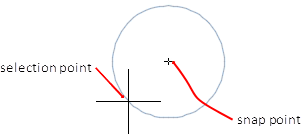

Center
Snaps to the center of an arc, circle, ellipse, or elliptical arc.

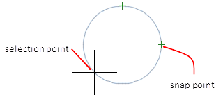

Quadrant
Snaps to a quadrant point of an arc, circle, ellipse, or elliptical arc.

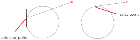

Extended intersections as shown below are available only as overrides during a command, not as a running object snap.
Intersections and extended intersections do not work with edges or corners of 3D solids.

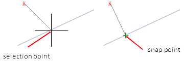

Apparent Intersection
Snaps to the visual intersection of two objects that do not intersect in 3D space but may appear to intersect in the current view.
Extended Apparent Intersection snaps to the imaginary intersection of objects that would appear to intersect if the objects were extended along their natural paths. Apparent and Extended Apparent Intersection do not work with edges or corners of 3D solids.
Note: Results may vary if both the Intersection and Apparent Intersection running object snaps are turned on.
