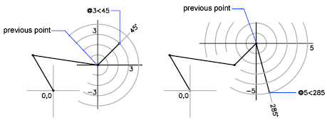

The following example shows two lines drawn with relative polar coordinates. In each illustration, the line begins at the location labeled as the previous point.
Command: line
From point: @3<45
To point: @5<285
