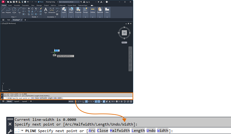

Anchoring the Command Window
An anchored command window adheres to the top or bottom of the drawing area.
If you move or resize the application window, the anchored command window retains its relative position.

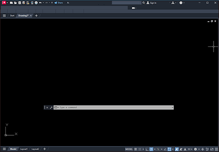

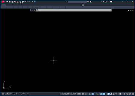

Floating the Command Window
If the command window is not docked or anchored, it is floating.
You can move a floating command window anywhere on the screen, resize its width and height, and increase its transparency.
Resizing the Command Window
You can resize the command window vertically by dragging the splitter bar, which is located on the top or the bottom edge of the window. Resize the window horizontally by dragging the right or left edge.
