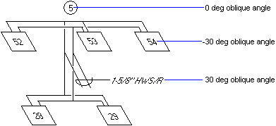

Specifies the oblique angle of the object.

The angle in radians within the range of -85 to +85 degrees. A positive angle denotes a lean to the right; a negative value will have 2*PI added to it to convert it to its positive equivalent.
Remarks
The oblique angle is the object's "angle of slant" away from its vertical axis.
