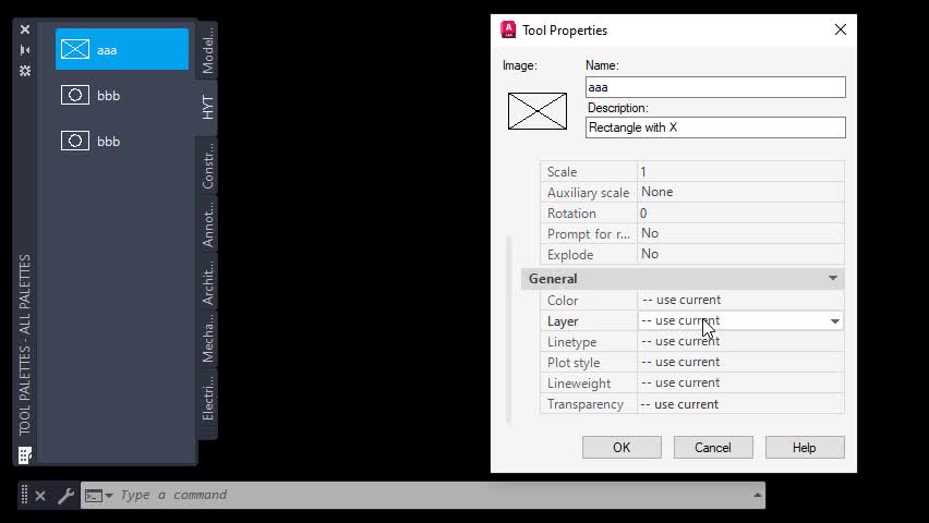

  9. Right-click each of the blocks that you added to the HYT palette and choose Properties from the menu.
    • Enter a description such as Rectangle with X for aaa and Rectangle with hole for bbb. The descriptions act as tooltips.
    • Set the default layer for aaa to A-support and for bbb to B-Support. This setting ensures that these block references appear on the specified layer regardless of the current layer.
    Note: If the layer that you specify isn't present in the current drawing, the layer will be created automatically when you insert one of the blocks.
    Notice the other options in the dialog box that provide settings for a scale, a fixed angle, an angle prompt, and so on.
    There's no reason why you can't use more than one version of the same block on your palettes. Here's an example of two versions of the same block with one rotated 90 degrees.
