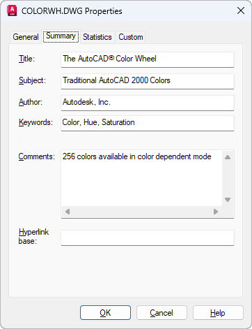

Summary Tab (Drawing Properties Dialog Box)
DWGPROPS (Command) Find
For example, you can add keywords to all your drawing files and then use DesignCenter to search for all drawing files with a particular keyword.
List of Options
The following options are displayed.
Title
Specifies the title you want to use when searching for this drawing. The title can be different from the drawing file name.
Subject
Specifies the subject of the drawing. You can use the subject name to group drawings that have the same subject.
Author
Specifies the author of the drawing. The author name can only be entered or changed by the user. To change the author, delete the existing name and enter a new one.
Keywords
Specifies the keywords you want to use to locate the drawing.
Comments
Provides a space to add comments to the drawing.
Hyperlink Base
Specifies the base address that is used for all relative links inserted within the drawing. You can specify an Internet location, for example, https://www.autodesk.com, or a path to a folder on a network drive.
