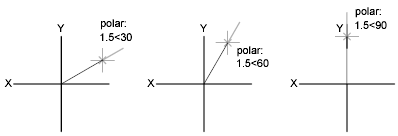

You can use polar tracking to track along polar angle increments of 90, 60, 45, 30, 22.5, 18, 15, 10, and 5 degrees, or you can specify different angles. The following illustration shows the alignment paths displayed as you move your cursor 90 degrees with the polar angle increment set to 30 degrees.
The orientation of 0 depends on the angle you set in the Drawing Units dialog box. The direction of snap (clockwise or counterclockwise) depends on the units direction you specify when setting units of measurement.
