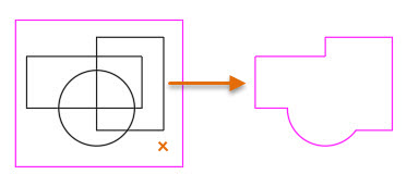

The purpose of the following steps is to generate closed polylines from an area enclosed by contiguous or overlapping objects.
  1. Create some geometry as shown below.
  2. Create a layer for boundaries named 00 Boundaries. Use a distinctive color and make it the current layer.

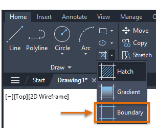

  3. From the Home tab, Draw panel, click Boundary or enter the BOUNDARY command.
    Note: With complex boundaries, you might need to zoom in to the desired area to avoid error messages.

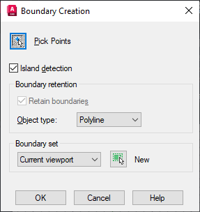

    The Boundary Creation dialog box displays with several options. The default settings are best choices in most cases. Make sure that the object type is set to Polyline.
  4. Click OK and then click within the interior areas at points 1 and 2.
    Two separate closed polylines are generated.
  5. To see them clearly, move the resulting polylines as shown below.
  6. Go ahead and erase the resulting polylines.

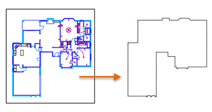

Enclose a Set of Objects with a Closed Polyline
Next, let's use a technique to create a closed polyline around a set of objects. For example, the foundation plan for this residence was generated simply by creating a rectangle around the floor plan, using the Boundary command within it, and then deleting any unneeded geometry.
This same technique can be used to create a single, closed polyline around a mechanical component or a compound map.
